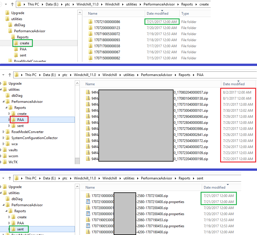

We recently updated to Windchill 11.0 M030 CPS01 and since the update we are no longer seeing data uploaded to the Windchill Performance Advisor website.  I do have a support case open but so far they haven't been able to figure out why.  Is anyone else having this issue?  Is there anyone out there running this same version and CPS of Windchill that is successfully uploading data?
There has definitely been a structural change under the hood.  The "create" and "sent" folders are no longer being used.  Everything is now happening in the "PAA" folder.  None of the items in the red box have been uploaded (as far as I can tell.)  WPA shows nothing after 7/21/2017.

In 11.0 M030, PA Agent sends the report to PTC.
Since I see you have updated to 11 M030, you would need to validate SCN from Site > Utilities > Windchill Performance Advisor page.
SCN validation will start PA Agent as service and start sending report.
Please note that to Validate SCN, Windchill is started as an Administrator user. After successful validation of SCN, Windchill can re-started as non administrator user.
The limitation of starting as an Administrator user is an issue and we plan to resolve it in upcoming CPS of 11 M030.
Anirudha
Before validating SCN, please set the value of property 'periodRetainReportsToSendDays' to 30 in internal.properties.
internal.properties is located in WT_HOME\PAAgent.
This property will esnuer that all the unsent reports of last 30 days are sent. Default value is 10.

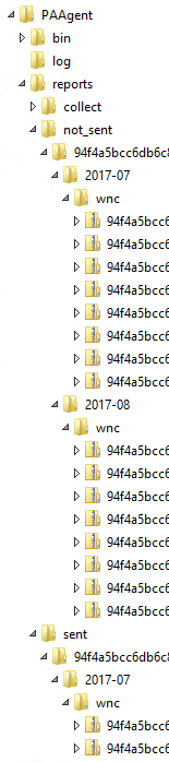

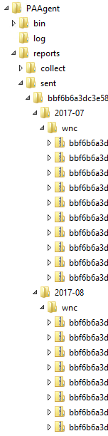

TomU
(To:ahanchat)
Fascinating.  There are indeed reports in the PAAgent sent folders.  The server that didn't have the service installed until yesterday also has a bunch of reports in the "not_sent" folder.
Full GUIDs have been sent to you via email...

For anyone who might be following this thread, it looks like we have a solution.
Starting with Windchill 11.0 M030, the piece built into Windchill to communicate back to PTC has been replaced by a stand-alone ThingWorx edge client called PAAgent.  It runs as a separate service (on Windows) and is installed automatically the first time the SCN is validated.  It is designed to monitor a set of folders and automatically upload new data back to PTC each day.  It is possible to install this agent by itself and use it to collect performance data from other servers that do not have internet connectivity.
There were two issues with my servers.
  1. The service was not installed correctly.  Re-verifying the SCN corrected this (after three attempts.)
  2. The Windchill Performance Advisor website was not correctly ingesting the data generated by this new agent.  A fix has already been developed and will be deployed to PTC's production servers tonight.
There are several new articles that tech support is working on to more fully explain all of this.  For new installs or updates to existing installs, it is important to re-verify the SCN.  This will make sure the service is properly installed.  For rehosting scenarios, the process now looks like this:
  • Stop the agent (if it's already installed)
  • Uninstall the service (PTC will provide a command line utility to do this)
  • Rehost
  • Startup Windchill
  • Run the GUID change utility (CS236189)
  • Restart Windchill
  • Re-validate the SCN (so the service can be reinstalled)
