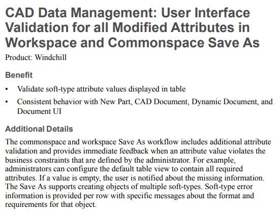

I'm very interested in 11.2's enhancement to the Save As function.  Here's a clip from the What's New document. Sounds really good but doesn't tell me if you can input part numbers as part of your Save As.  I've had CAD users for years wanting to be able to do this, but I still don't think 11.2 is providing that much flexibility as the new objects are being created from the old ones.
What do you folks think?
