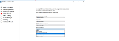

Hello ,
We  are tried to install WC 11.0 in azure cloud , but we don't have any option to select cloud database instances.
Please refer the below screenshot and suggest.
Thanks.
