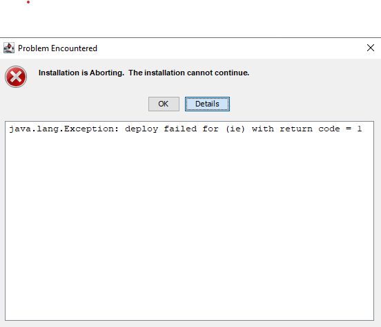

Windchill 11.2 installation aborts as "installation is aborting"
AI_10204028
8-Gravel
PSI shows this error in detail and installation fails.Screenshot 2022-12-26 130353.png
java.lang.Exception: deploy failed for (ie) with return code = 1.
I have attached a log file generated also please someone help me with it.

I checked that article, and my system specifications are appropriate and still I am getting this error message.

The other possible reasons:
  • The password of the WindchillDS administrator cn=Manager contains special characters e.g. @,*,$.
  • The Info Engine installation media is corrupt. Download new CD from PTC ESupport
  • https://www.ptc.com/en/support/article/cs355004 (This only for reference. currently, from the attached log, should not relate this issue)
I have not used any special characters in password
can you tell me how to set cn=Manager password without encryption

Once you finish installation. you will able to see the password from <HTTPServer>\conf\app-Windchill-AuthProvider.xml
This error message is shown before completing installation, so I am not able to see these files.
