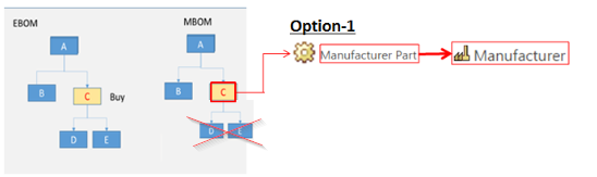

Please find the attached file for the detailed issue in the MBOM creation for the BUY Part.
Requirement: In the below EBOM structure consider that C is purchased from the Supplier, so while creating MBOM "C" will be added as an End Item (without adding the child components D & E)
Issue: MBOM visualization doesn't show "C"
Any suggestions would be helpful.
Thanks in advance.

Hi all,
some of my experience/thoughts:
Our company also needs to manage suppliers' BOM in our eBOM - we provide them the CAD parts and drawings so it should be integral part of our eBOM (parts C,D,E in the attached schema).
Sometimes part C is not manufactured by external supplier, but by another from our plants (intra-company transaction).
Option-1: Available only when Windchill Supplier Management is installed. If used, would the Manufacturer Part object not be considered as discrepancy in Reconiliation tool (when children D&E are missing in mBOM)? Looks very promising. Today this behaviour is missing in MAPSB and it bothers us a lot.
Option-2: If you create new downstream part as End Item, it will automatically set upstream part as End Item (unacceptable option).

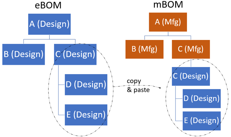

From my perspective the Reconciliation assistance is actually causing most difficulties in eBom-mBOM transformation. Some thoughts/ideas below:
Option 1 (workaround): Create a new downstream part for part C (Design view) and paste the downstream part C (Design view) into it.
When pasting upstream part C "without propagating" the children (D&E) will be included as well.
So practically you need just to create new downstream part and paste one upstream part into it.
Not the perfect solution but the best so far. It solves the problem of discrepancy status (in Reconciliation assistance).
