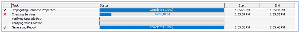

Starting condition:
Windchill 12.0.1.0 fully configured and happy, but not live in production yet.  Need to execute at least two more successful upgrade manager runs before going live.  Previous upgrade manager runs occurred prior to updating the installation from 12.0.0.2 to 12.0.1.0.
Steps to refresh from production:
  1. Export the database from source (11.0 M030) and use it to overwrite the target (12.0.1.0)
  2. Export the LDAP from source, append it to LDAP from target, and then re-import the merged file to target.
  3. Fix the JDNI adapter names. (See CS337415 step 5)
  4. Copy the file vault from source to target
  5. Run the upgrade manager from Windchill shell
  6. Remove data from TableViewDescriptor table in the database. (See CS300564)
  7. Add missing translation preferences.  (See CS225163)
  8. Reset the GUID (server must be running, restart after changing)
Since the update to Windchill 12.0.1.0, the process is now dying at step 5 - run the upgrade manager:

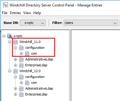

The configuration branch on the source (running on the target) is most definitely there:

To be clear, these problems are only occurring with 12.0.1.0.  With 12.0.0.2 and prior, no manual editing of the merged LDAP file is required.  The upgrade manager runs fine and completes successfully with no errors.  I actually rolled my installation back to 12.0.0.2 over the weekend and re-ran the entire upgrade manager process.  No issues at all.  The problems only start happen after updating to 12.0.1.0.
Arpit-Singh
(To:TomU)
Thanks for the info Tom.
The above error you mentioned above is not expected. But as you mentioned let's have the investigation finished through that case and please update us once you know the cause.

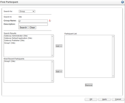

hello all,
I have given up on installing 12.0.1.0 without WindchillDS....

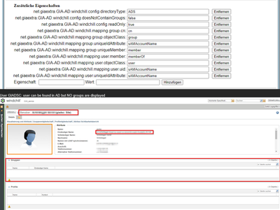

The installation Windchill 12.0.1.0 basically works, the users from the ActiveDirectory are also available. But the groups from the AD can not be found, although this is entered in the database in the table wtGroups, after a search of the users....
The PTC supporter has reported this to R&D, but so far I have no feedback on this.... Let's see how it goes on here.

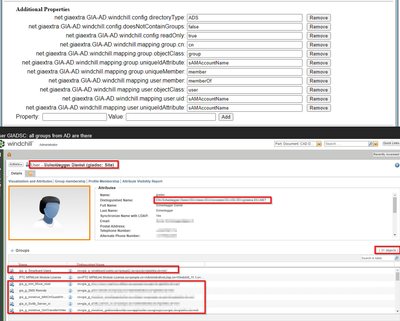

So for me, I did a brand new install and configured WC 12.0.1 with AD.
And I can search the groups and users from AD

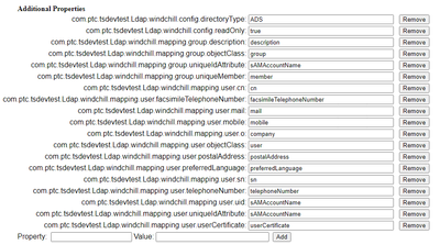

Here is my JNDI Adapter mappings:
Arpit: I read in PTC that json files will hold infoengine entries. Please help me with the location of these json files.
Also I do not see any url (Corporate Ldap) in the screen shot share above by you for.

for quick reference > The Info*Engine configuration JSON files are stored in Windchill/IEConf folder. Path to this folder is specified by com.infoengine.config.dir property.
Also the Corporate LDAP URL is present in the info-engine configuration, its just that screenshot does not have it.

I have already installed Windchill 12.0.1.0 several times and also tried various tests and configurations with PTC (CS15745873). I have escalated the case and it is currently at R&D.
For your understanding, in 12.0.1.0 with following filter, I get the yellow warning symbol:
adding the Filter windchill.mapping.group.filter
at least the Windchill Licensing groups are visible, but no AD Groups
in 11.1 I have the following, and that is working:
