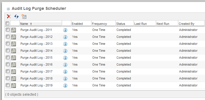

After upgrading to Windchill 12 Audit Log Purge Management page stopped showing purge results. Does this mean that this page really stopped working in showing purge job results after Windchill 11.2?
TomU
(To:Alexa)
Right, it works prior to 11.2, and only shows results from runs prior to 11.2.  Seems like someone should have removed it.

Hi Tom, And I suppose you are running audit log purges on regular basis?
TomU
(To:Alexa)
No, not on a regular basis, but I have definitely run some in the past.  They show up on the 'Audit Log Purge Scheduler' page:
TomU
(To:Alexa)
Found it:  CS341757
So essentially a useless page after 11.2.  Seems like maybe they should update the description text:

But it's still there under Auditing Administration section. But it's not working I guess.
TomU
(To:Alexa)
