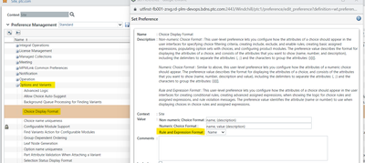

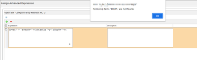

I would like to create advanced expressions when the choice names are the same.
In the help I found this info.
Is it possible to assign advanced expressions?
Thanks in advance.
Nora

check below O&V preference, seems that it is set to number instead of name :
Fede
