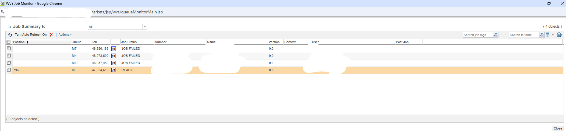

Hi @JavierL . I did not clearly understand the solution. Can you please help me with it. As a part of the manufacturing team, I too work on large assemblies. But the 'particular job' I am working on says 'job failed' when I check on the 'WVS monitor'.
I click on the icon which supposedly should re-direct me to open a CreoView session, but the job isn't getting published in Windchill and hence I cant view it in CreoView.
