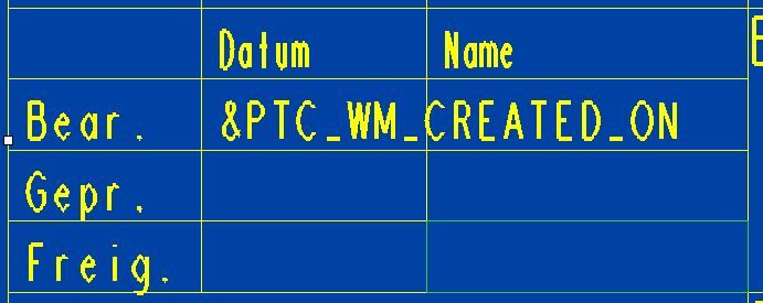

I hope you can help me.
I'm looking for the appropriate parameters to note on the drawing who checked and approved the drawing and when it was made.
I have already found the parameter for the creator (&PTC_WM_CREATED_ON and &PTC_WM_CREATED_BY) and am now looking for the parameters mentined above.
thank you in advance.
There are none.
We carry those as drawing parameters only using a restricted _params.txt file to limit the names that may be used.
Okay.
I think we will just let it open to let them put their names and dates inside.
