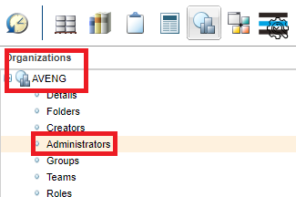

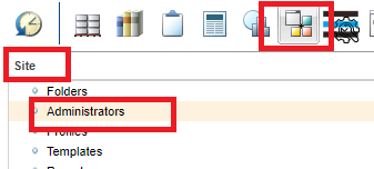

Hi @Unreliable_User
Normal user can not see that icons. org/site level. Only administrators can.
There is not difference between normal/enterprise version. All Windchill versions from 10 to now has this icons. Just appearing is based on an access. Org admin can see org level, Site admin can see site level.

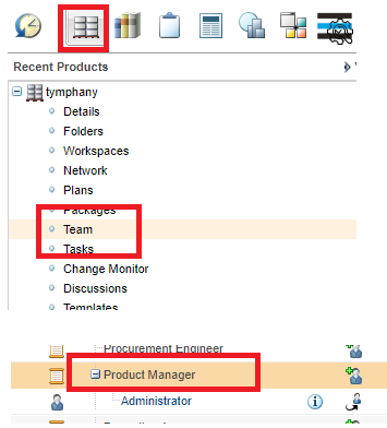

Product Manager can manage a teams and so on.

You need to add user to the project team, as a member, or another role.
An access is granted by ACL rules, OOTB each role in a team has some ACL definition that grant the access.
Also do not forget to assign license group to the user.
