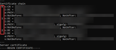

Concatenating the certs into the server.crt file presents the entire chain to the client.
You can test this with an openssl call (go to openssl/bin folder)
openssl s_client -connect <server fqdn>:443
Try without the concatenated cert, The call should return the SSL info. Above the SSL cert returned, it will include the chain - with just the server cert it will look something like this:
With the concatenated cert you can see all the presented certificates:
