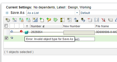

When we are trying to use the Save-As Function in our Windchill for the Windchill Part, Model and Drawing we get an Error Message that the Object Type is invalid.
I didn't find any preference which prevents the copying of CAD-Models/Drawings.
Is it possible that the Save-As Function is not working with Data from Direct Modeling?
Thank you in Advance!

Hi
The Save-As function is not available for Creo E/D Modeling CAD documents. One reason is that Windchill cannot change the System-ID (must be unique) of the models.
Kurt
