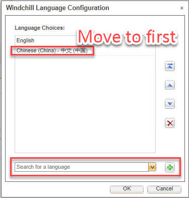

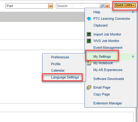

Windchill UI cannot be set to Chinese, it is always English
YZ_10818805
Hello @YZ_10818805
Try this:
1 REPLY 1
Hello @YZ_10818805
Try this:
