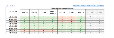

In the compatibility matrix of Catia V5-6R2017, there is a discontinuity between 12.1.0.2 and 12.1.2.0. It is strange from my point of view. May be you should test with version V5-6R2022 of Catia.
https://www.ptc.com/support/-/media/support/refdocs/Windchill_PDMLink/compatibility/WWGMCompatibilityMatrix.pdf?sc_lang=en
Pascal
@Pascal_Brunet
The reason of the discontinuity is that 12.1.2.0 version is a long term support version.
PetrH
Yes - this was frustrating for us. We were just about to upgrade to WC12 globally, with WGM 12.0.2.0, which we had validated against all our 15+ CAD packages & versions and then PTC dropped a security notice forcing us to have to deploy WGM 12.1.1.0 which did not "officially" support V5R26, 27 & 28 (but it works).
Then a month after the upgrade, they released 12.1.2.0 which did support these versions. But by this time we had done our upgrade and installed WGM 12.1.1.0 on 300+ CAD machines!

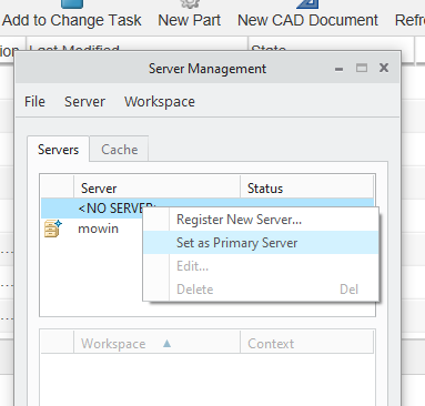

Offline Workspaces are only available for Creo Parametric - not CATIA via the WWGM
If you set <NO SERVER> as Primary server:
That is not working offline, it disconnects the WGM from the Windchill Server - so you would not be able to see your workspace, let alone reproduce the issue.
The idea is to reduce the time your designers lose every day with this issue.
I suppose that if your designer is disconnected from the server, then he doesn't have any freeze issue with Catia.
