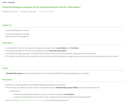

I was really hoping this would work, but WGM clearly changes it, at least after WGM 11, per an article I reference below.

Per this PTC article
https://www.ptc.com/en/support/article/CS293782
