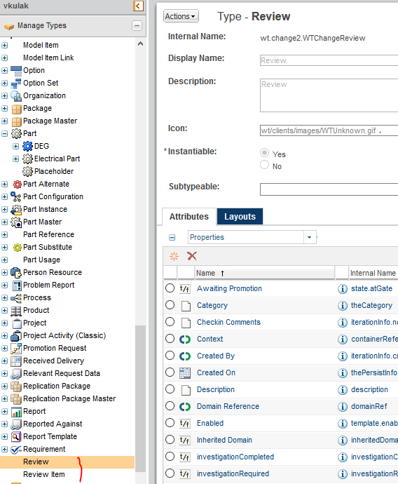

I'm in the same case ( 11.0 M30 CPS 8 ) and no action menu.
I suspect an upgrade problem because i have the object but with Unknown icon.

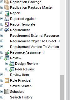

You might have to have a license for it.  We use it here at my work. I am actually about to do a webinar presentation on it for our 30,000 Windchill users later this month. It is listed after Requirement.
Please remember that Review was partially implemented for 11.0 and improved in 11.1 and 12.0. We had issues with it originally due to missing ACL's and Roles that were not populated into our products created from a non-OOTB template. Attached is the documentation I wrote up at the time of the investigation. Hopefully it will help get you pointed in the right direction.

This is my guess, an upgrade to Windchill was never addressed to add proper types/acls etc
