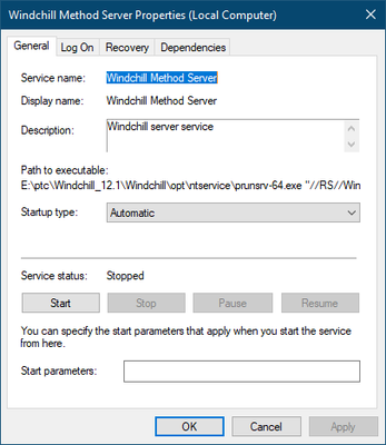

Installed Windchill as a service, set to Automatic start and rebooted.
Windchill did not start.
Opened services and clicked on Windchill and pressed Start.
Got an error message:
Windows could not start the Windchill on the Local Computer.
For more information, review the System Event Log. If this is a
non-Microsoft service, contact the service vendor, and refer to
service-specific error code 1.
System Event log says Windchill has an Incorrect function.

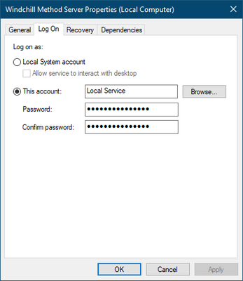

Hi @BenLoosli
Check the user who run the service.
I have had experience that the user does not have correct rights/access.
The NTSERVICE user was used in the past but in Windchill 12.1+ it has been changed and I usually change the user to the NTSRVICE and the windchill service works.
PS: the change of the service installation could be changed in the previous versions 12.0+.
PetrH
All are being run from my 1 logon to Windows and I do have administrator privileges.
Hi @BenLoosli
You can think that you have but my experience is different.
Try to set this one>
PetrH

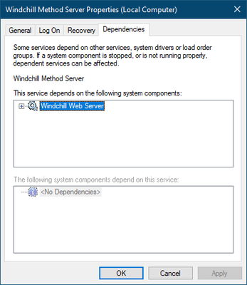

- Add startup dependencies to method server service:
sc config "Windchill Method Server" depend= "WindchillWebServer"

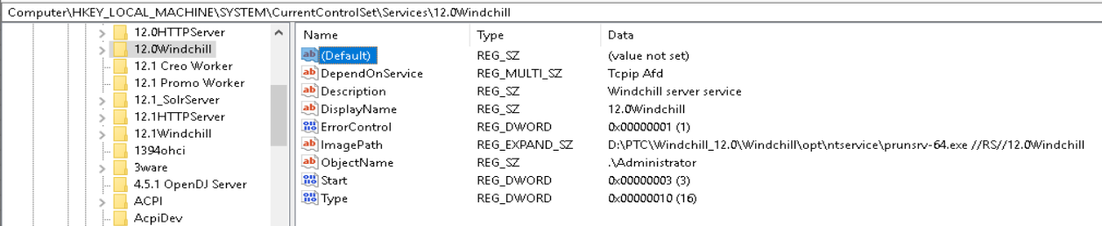

Probably won't see a difference, but here are the registry values of a Windchill service that is working.

(I manually added this dependency)

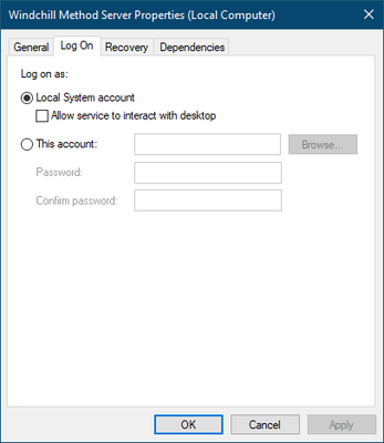

Uninstalling and re-installing the Windows service (for that earlier test) 'broke' Windchill. The method server failed to start correctly:
ERROR [main] com.infoengine.au.json.parser.IEJSONParserHelper - IEJSONParserHelper.readJSONAndInflateCache FAILED !!!
ERROR [main] com.infoengine.au.json.parser.IEJSONParserHelper - IEJSONParserHelper.readJSONAndInflateCache ERROR !!!E:\ptc\Windchill_12.1\Windchill\IEConf\adapterservice.json (Access is denied)
ERROR [main] com.infoengine.au.json.parser.IEJSONParserHelper - IEJSONParserHelper.inflateJSONObjectCache ERROR !!!E:\ptc\Windchill_12.1\Windchill\IEConf\adapterservice.json (Access is denied)
INFO [main] wt.system.err - com.infoengine.exception.adapter.IEAdapterException: Unable to perform read operation. Please contact your Administrator.
INFO [main] wt.system.err - at com.infoengine.json.QueryObjects.run(QueryObjects.java:182)
Comparing this test system with my production system, the 'Log on as' settings were different. Changing it to use the 'Local System account' fixed it.
INFO [main] wt.method.server.startup - MethodServer ready (in 122.402 secs).
I am set to use the Local System account for the startup of the Windchill service.

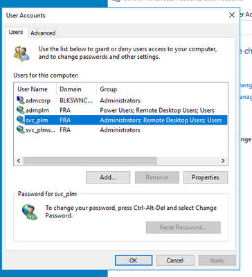

@TomU, thanks for the screenshot. I was having the same issue and this fixed it for me.
i had similar problem in 12.0.0.3. I solved it by replacing local system by an administrator account. Check my original note i created last time it happened to me.
svc_plm is not an account i created myself on the server. It is an account created by our Server team in the Enterprise Active Directory:
Hope it can help.
Best regards,
Pascal
