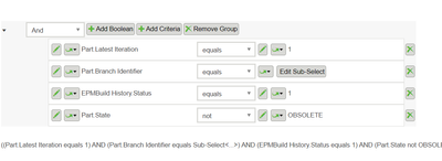

I don't know an easy way to fix, but here's a way to help find them. I use this query to find parts not built:
You will need to test this out and probably customize for your system. The sub select is to limit the search to latest revisions only. I'm also omitting obsoleted parts in our system. The key constraint is that EPMBuildHistory.Status = 1.

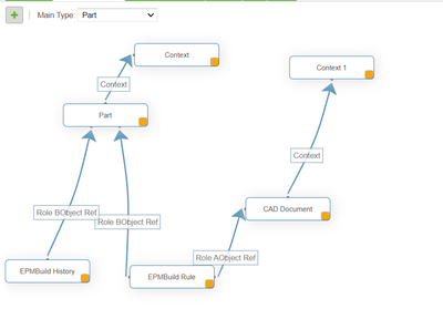

How do I need to access this setting?
I shared screenshots from they Query Builder tool.
You can learn more here: https://www.ptc.com/en/support/wnc-reporting-landing?source=search
Or just search the Support site for "Query Builder". There's lots of references across the Support page as well as the PTC Community.
