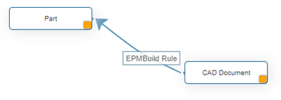

This join using query builder will give you a list of all parts associated to CAD:
What you then need to do is construct a query for all cad docs who are not in that query above. You can use a subquery to do this. You can also add any other conditions you need to exclude those prototype parts.
