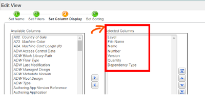

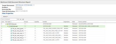

There is a multi level BOM CAD report in Windchill.
The requirement is that we need to add a new column for "Parent Part Number"
I need your input, Please provide me support

Hello , it should be possible using alias attributes with mapping
masterReference@wt.epm.EPMDocumentMaster~uses@wt.epm.structure.EPMMemberLink~usedBy^wt.epm.EPMDocument~number
we can then add the alias attribute to the given report
Note the alias attributes are getting info from DB with  no filtering , so if a CAD is used in 2 assemblies, it will show both not only the one in current structure
