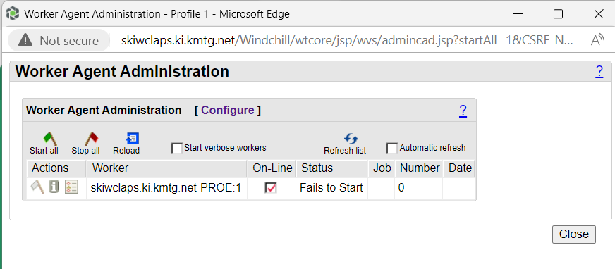

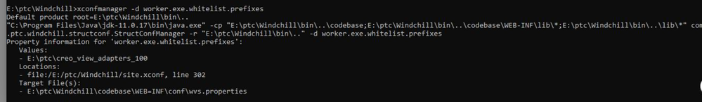

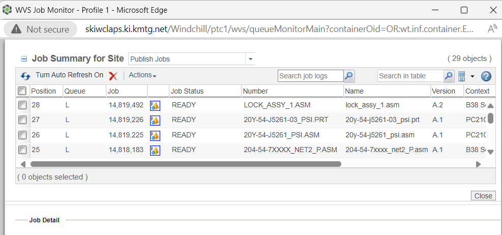

Use Case: Hi, I'm having trouble with Windchill Worker Agent. I use windchill 12.1.2, Creo adapter version 10 and Creo parametrix version 10 for my worker agent proe needs. The adapter is stored on the monolith system, I have directed the worker to preoworker.bat, it has been successfully tested from the worker to the server. but the flag in Worker agent administration is still white (executable not safe). I tried to run proeworker.bat manually, and when I restarted the worker agent administration flag, it could be clicked to red. but all publications in wvs job monitor remain in "READY" status, there are no errors whatsoever in the methodserver. I have created the auth.properties file, have also done xconfmanager for worker.exe.allowlist.prefixes & worker.exe.whitelist.prefixes to the creo view adapter path where preo is located. I've also made sure Workerdaemon is running on port 601. What else do I need to make sure?

proe2pv 10.0.0 - Build: 20.0.0.0-P5KNN2 x86e_win64
Copyright (C) 2000-2023 PTC Inc. All Rights Reserved.
[2024-10-29 15:02:57] Starting ProE :
just like this
the flag is green and status is fails to start
[2024-10-29 15:02:57] Starting ProE : proe2pv 10.0.0 - Build: parametric10000 20.0.0.0-P5KNN2 x86e_win64
[2024-10-29 15:04:33] Connecting to server "SKIWCLAPS" on port 49784
[2024-10-29 15:04:33] Connection established
[2024-10-29 15:04:33] Registering as WORKER3 skiwclaps PROE
COMPLETE
when i click start again the flag is red, and log displays as above. but the wvs job monitor status always READY for publish record

i have following the step but status in wvs jobmonitor always ready state
