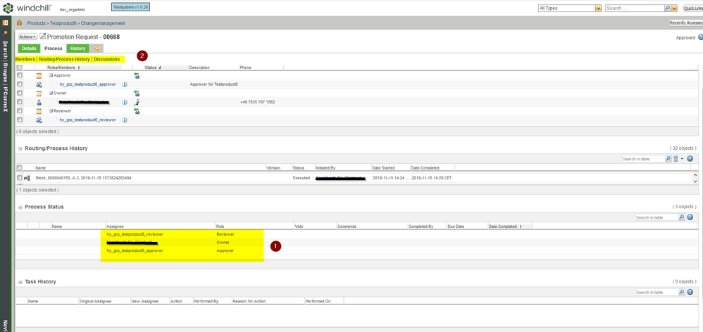

we have an issue with the process status table in our promotion request workflow.

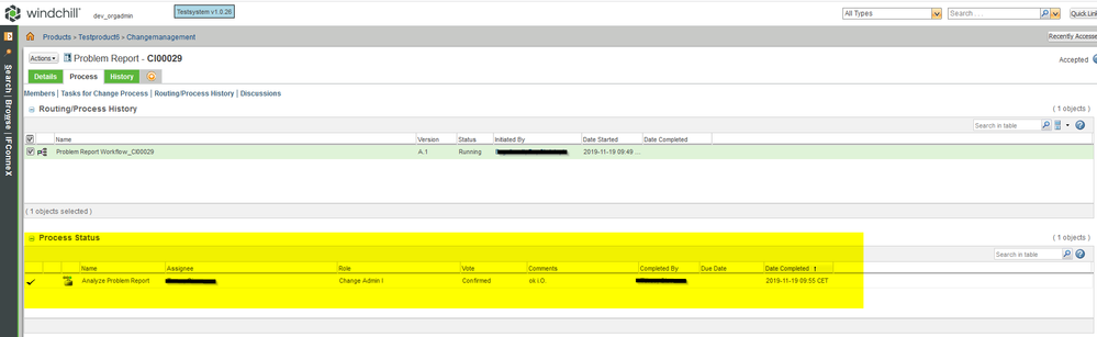

When a workflow is completed, e.g. a problem report, the process status, the task history is shown in the process status table:
In promotion request, the process status only shows the group assignments, but not the completed tasks (1). This makes it difficult to retrace the process. A minor issue is that the process status table is not shown in the top (2).
Any ideas how to debug this further and make Windchill to show the task history as in other workflows?

It looks like you have multiple workflows on that Promotion Request.  Once you select one of the workflows in the Routing table, it should show you the process status of that workflow.
