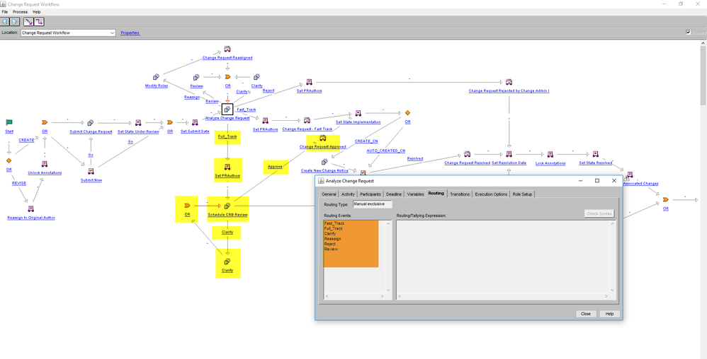

I am looking for a way to remove routing options in workflow tasks.

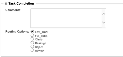

Case: The default Change Request workflow creates an "Analyse Change Request Task" with several routing options:
2019-11-07 08_57_40-Task - Change Request Workflow_CR00092-Analyze Change Request - Internet Explore.png
We would like to limit the choice to "Fast Track", Clarify, Reject.
In the Change Request workflow template I found the "Analyse Change Request Task". There is a tab with Routing where I see all the available options. However I couldn't find a way how to disable certain options.
Thank you in advance for any hints how to achieve this.

Edit the workflow template.
Find the Activity (person's head icon).  See the Routing tab of that activity.
Note: Be very careful to examine the links leading away from that activity after removing routing choice(s).  May have to re-select the intended choice for some links.
that's were I got stuck. I opened the template, opened the "analyse change request task" and found the routing options.
In the routing tab, there is no option to delete or add routing options (orange marked area in the screenshot attached).
I tried to delete all workflow elements related to the "Full Track" (yellow marked element in screenshot), but the "Full Track" routing option remains in the "analyse change request task".
Any tips on how to proceed?

You may be viewing rather than editing the workflow template.
Take a giant step back though...
In general, leave all at site level as provided alone.  In general, Save As at Org level and edit for your needs. This applies for (at least):
- OIR for each change object
- Lifecycle Template for each change object
- Workflow Template for each change object
You can also do this in a test Product/Library (OIR, Lifecycle, Workflow in that context), to test these things in a controlled way before making available to all.
Use slightly different names for each so that you know which are in fact being used.
