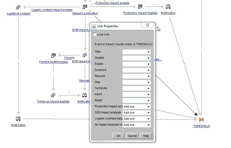

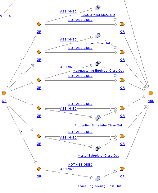

I have a workflow that has 4 optional routes and the user can choose any combination of routes, at the end I have an AND connector because I need it to wait for all routs that were selected to finish but the AND connector is waiting for all 4 routes to finish and in most of the cases only 2 or 3 routes will be chosen.
PTC tech support has not been much help so I am looking to the community.
I attached a word doc to help better explain my needs.
Thank you,
Hi
I had a similar problem, which i solved by using the Threshold and set it to 0, then i had a string going from the task where the amount of routes are selected, this will add one to the threshold. EG if the user selects 2 routes, then string will add 2 to the threashold, and then it will only fire when the two routes are completed.
Regards Jacob

May be easiest to create a workflow variable and present it to the user, then have a conditional after the activity which routes down one or more paths.  Could also put the routing code on the activity complete transition.
bcedar
(To:Billy_Johnson)
I like to use OR connectors that route to the AND.
First a Conditional OR that checks for a Boolean (I use booleans for my routes), if the Boolean is true, fire off the route, else, got to a second OR, the route goes to that same OR and that OR goes to an AND.
This way, no matter the selection, all routes leading to the AND have a determined route.
Hi
Regards Jacob
