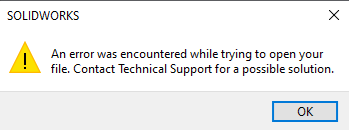

Here's a Windchill 13.0.1.0 help page about how to configure Windchill with SolidWorks Toolbox for an admin to setup your SolidWorks Toolbar library. If this is already complete all the Toolbox CAD files should be in Windchill (presumably in a library location where most users can't check them out). If this is done correctly, using Toolbox with an assembly should just add the existing Toolbox files from Windchill to the user's workspace. We are currently getting a fake error message when placing toolbox items, but we think it might be related to using SW 2021 Toolbox CAD in SW 2023 (not sure).
Users can just click OK and everything works.

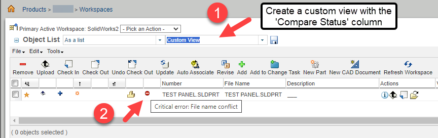

When you import files from outside Windchill to Windchill, you will need to resolve file name conflicts before checking in. If you create a custom workspace view, you can add the 'Compare Status' column. This column will give you a red icon for any file name conflicts, and you can also sort by this column to bring the file name conflicts to the top of the list. A Windchill admin can add this column to the default All view or create a new view for all users if desired.

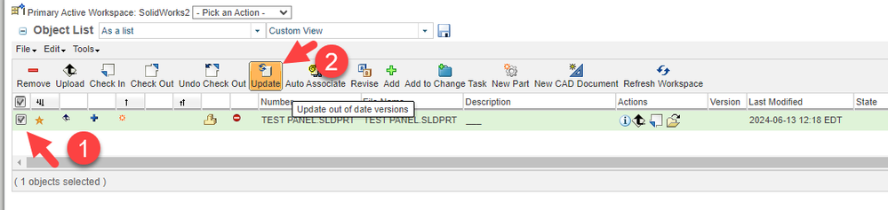

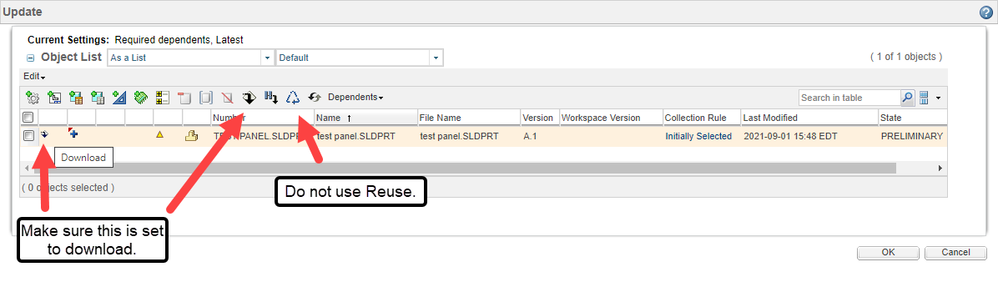

If you wish to replace the conflicts with the Windchill version, you can use the Update command with Download (not Reuse!). Download will download the latest file from the Windchill Commonspace and replace the local file. Reuse (recycle symbol) will reuse the local CAD in your workspace and update it's metadata.
I believe there's some Windchill preferences for whether it defaults to Download or Reuse. We've set this to download by default.
