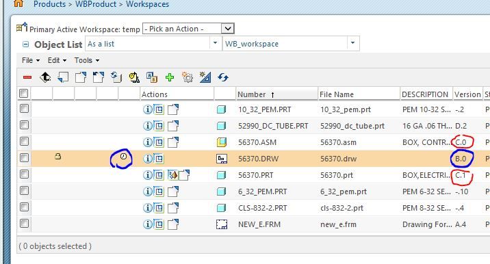

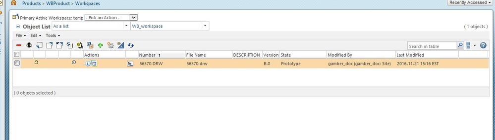

We recently migrated from Intralink 3.4/WF3 to WC 10.2/Creo3.
I have discovered an issue.
If we pull a drawing at an older revision using "as stored" with dependencies of "none" only the drawing is placed in the workspace at the intended rev. If you open the drawing in Creo the system pulls the latest parts. In this case we had in Creo a rev b drawing with rev c models being shown with no warning or system interaction. This is a problem. Can anyone tell me if this is out of the box behaviour and is there a way to stop this from happening with a preference?
