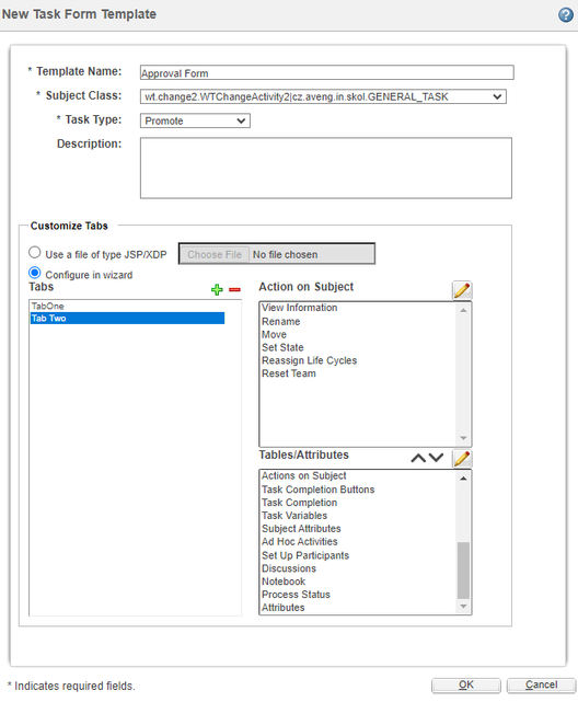

I am using Windchill PDMLink Release 11.0 and Datecode with CPS M030-CPS22
What can I do if a custom task template is used only for a certain workflow node and no custom template is used for other nodes? Now if we turn on custom templates in preferences, all nodes will become template views, which is not what we want

If you turn on the custom template tasks, then you need to define own custom template for each task node.
or you can use Task Form Template where you can define how the task should looks like.

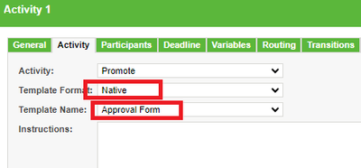

After you create Template Form task, you define the Form on the task in the workflow .
Using Custom Task Form Templates in Windchill 11.0
