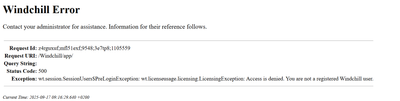

Thank you @mmeadows-3 . i have successfully rehosted my dev server. but all the users are facing log in issue. only WCADMIN can login. we are using AD to provide access to windchill to all the users. need your help again to resolve this.

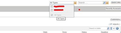

Also, the values in the drop down menu has been changed. it is not as same as before.
Menu changes are not related to the rehosting script.  Those values are driven by preferences which are stored in the database.  They should be the same between source and clone.

Confirm the source doesn't have the same values.
Maybe try clearing the browser cache.
The rehost script does not resolve licensing.  As your default Site Administrator account, login and update licensing.  Site > Utilities > License Management.
So , I need to retrieve the license online? because i don't see any license related notification there.
Br,
Sandeep C.
Is this a new Dev system or a data refresh of an existing Dev system?
The login error you shared is a licensing error.
Can you confirm there are available licenses?
Can you confirm the person is licensed?
the rehosting done to refresh the data of an existing dev system. i retrieved the license again.
but still facing the issue. all the users are set as disconnected from DS in participant management utility.
User account must be repaired in Windchill to match against the Dev ldap before they can attempt to login.
Disconnected participants with assigned licenses still consume those licenses.  It only shows four consumed 'access' licenses, 2 base and 2 advanced.
Your first screenshot shows a 500 error/licensing exception/unauthorized message.  So, I'm guessing the account you are logging in with has been repaired, but is not licensed.
Search PTC's knowledge base for the error you are getting on login.
