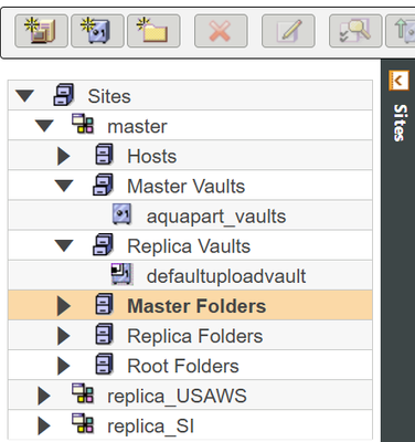

we are doing windchill rehosting of our dev environment (Windows based). we have filled all the required data in the rehost.properties file but we are stuck at vault section.
what does those '0' and '1' means in the attached snap vault_properties.png?
we have master vault and a replica as shown in below snap
Windchill version 12.0.2.7

1. the vault is configured on the same server where application is installed. so the path you have mentioned in the 2nd scenario will be applicable right?  and also the vault folder should be copied from prod to dev server ?
2. what are the efficient ways to copy the vault drive (80GBs) from production to development windchill servers (both are hosted on different VMs). Eg. below both the drives are for vaulting for production.

1. Yes.
Per your images, it appears the system is using the default upload vault and it resides inside the Windchill load point.  The master vault has a read-only root folder mount on the E drive and a read-write root folder mount on the F drive?  The clearer picture would be the mount paths from Site > Utilities > Vault Configuration > Site > Master > Root Folders.
Provided drive letters and paths are not changing, you can just change the host names and not worry about path mappings.

A. You can also skip file vault rehosting in the rehosting script and just do it by hand through the the Site > Utilities > Vault Configuration page.  If you are doing it just once, do it by hand (3 minutes effort).  If you are planning to rehost the dev system regularly, invest the time to use the rehosting script.  Really, in your situation, assuming all the drives and paths don't change, all you are doing is renaming the master site's host. In Dev, after finishing the rehosting script, select Site > Utilities > Vault Configuration > Sites > Master > Hosts > double click on FQDN and rename it to the Dev server's name.
