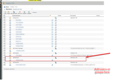

Please find attached a screenshot. It is product --> Teams
