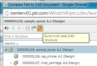

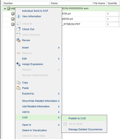

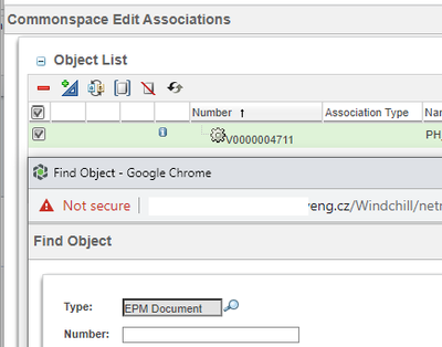

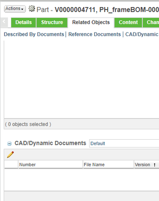

Create new CAD Assembly,
connect the CAD Assembly to generated WTPart
Search for the CAD assembly
In the structure use Build to CAD
The Publish to CAD will propagate WTPart structure that have associated CAD parts to the new CAD assembly.
PetrH

As my understanding, you explain me how to use 3D model to generated right bom, but my problem is : my configuration assembly 3d model is very large, and  very complex, there are many options in the 3D model,  its very difficult for me to open a such big 3D model to generate  the project 3d model, so i wonder if there are any wey can make this task easier.
