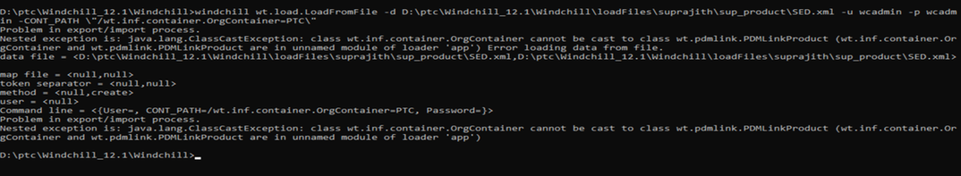

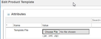

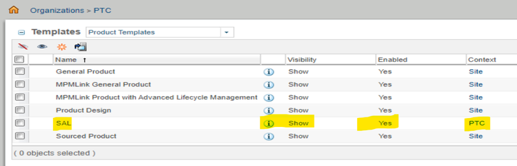

Yah i tried by loading that xml through import in UI level its importing. Now i am trying to load through loaders.
In the below image, i import the Tag-0.xml through UI level, template get created , and same xml i tried through loader it was failing.
this is my bat file, once i run that bat file it will execute the load command from the windchill shell.
error message after the running the load command

this is the command i am using :-
windchill wt.load.LoadFromFile -d D:\ptc\Windchill_12.1\Windchill\loadFiles\suprajith\sup_product\TAG-0.xml -u wcadmin -p wcadmin -CONT_PATH \"/wt.inf.container.OrgContainer=PTC\".
I modified and i tried it is not loaded.

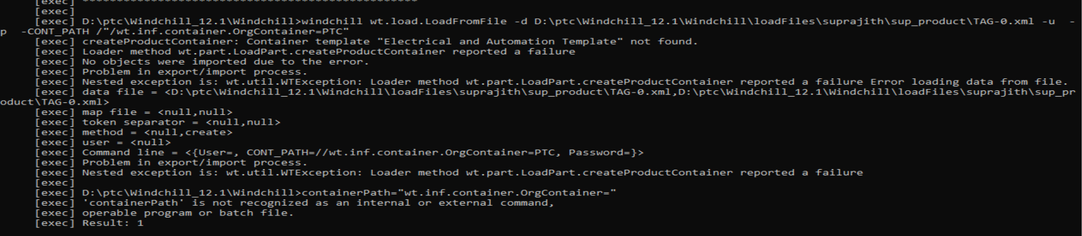

this is the error message i am getting and i have one more query how the template name get created.
This is the MS logs i found only this much
Please anyone can help me to load the product template through a loafromfile utility.
Hi @RaikarRaghu
the log says that you use organisation container instead of product container.
so your xml can be bad.
