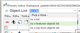

has anyone else seen this, the weird part is doesn't always remove the objects, its kind of a hit or miss thing but lately its becoming way more consistent.
i have the preference set to keep checkout after check-in, and when i'm done with it i just do a mass undo checkout either from the workspace or from the workspace menu where it shows all my workspaces and at the bottom it shows everything i have checked out, but then when i go back in there i'll have objects missing from the workspace, sometimes just the drawings are missing and the assemblies are still in there and other times the drawings and assembly are gone.
unfortunately i haven't noticed any patterns of when it does and/or doesn't do it.

Do you use default Object List view As a list ? or different?
Because your description reminds me that the view is set to "as a featured objects list",
description in a help Link to the Help
generally only specific objects are displayed. so undoCheckout can issue that objects are not displayed in a list

correct i use the default "as a list" option
when its gone i mean its gone as in "search in table" wont find it and if i do file open and use *partnumber* that doesnt find it either, its gone gone.
and just to clarify, it doesn't matter if i do undo checkout from the model tree with the files in session or if i do it from the workspace. most of the time those objects that i performed undo checkout are removed from the workspace.
