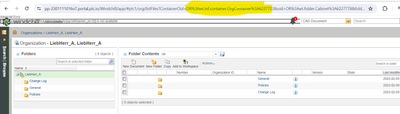

yep the "OR:wt.pdmlink.PDMLinkProduct:1048703300" is the ID of the prod where the doc is created , it can be also a library :
"OR:Awt.inf.library.WTLibrary:2956965", to be able to cerate product , add your self to an org (I know we are solving this in an other post  ) and then add your self under the org product creators table :
for to be able to create dox on org level use something like below :
OR:wt.inf.container.OrgContainer:xxx
