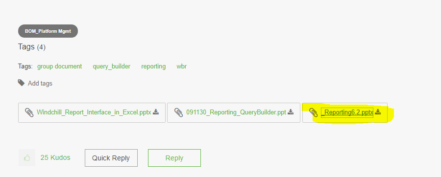

Marco, is it still available this presentation? it seems not working thanks
Yes, it is the one highlighted (just tried to download it).
You will find it at the end of my document.
