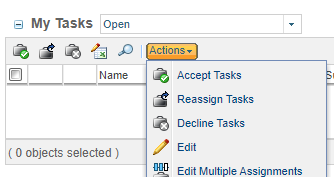

After upgrade from 12.0.2.9 to 12.1.2.0 the "My Tasks" table on the home page is missing the 3 multi task related icons and actions. The 3 missing icons/actions are: Accept Tasks, Reassign Tasks, and Decline Tasks.
I have not made any changes to anything related to roles besides upgrading that I am aware of.
This affects all users except for wcadmin. In the screenshot below the left is "normal" user and the right is wcadmin. Note the 3 highlighted icons and actions for wcadmin that are missing for the normal user.
Digging into it with jcaDebug=1 shows these are actually "removed by role-based check". See screenshot below:

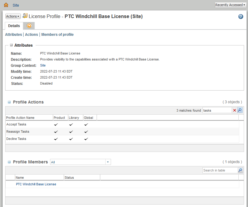

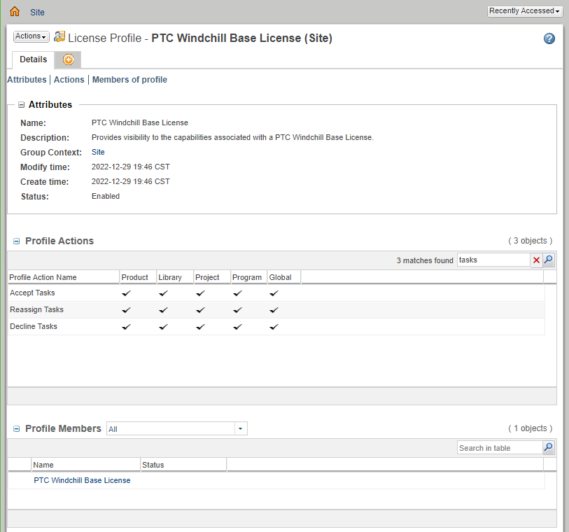

Also look at the license profiles associated with your account.  For example:
RandyJones
20-Turquoise
(To:TomU)
I had not looked at that however mine are as expected:

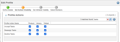

I just added a new test user to one of my test systems that belongs to only 2 profiles. Both profiles have all the *Tasks actions checked and the My Tasks table for this test user has the same issue.

Simply editing each profile, without making any changes, seems to be sufficient to get things working correctly.  Something is probably being added or updated in the database when 'Finish' is pressed, and this version of Windchill must be depending on whatever it is.

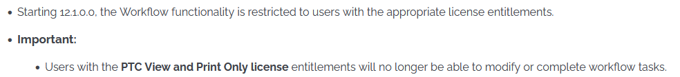

I'm guessing the issue is probably related to the change in this article.  It's just weird that it didn't show up until 12.1.2.0.  (My production system is on 12.1.1.2 and does not have this issue.)
https://www.ptc.com/en/support/article/cs364774
The upgrade manager (or update tool) probably needs to a step added to automatically recalculate all custom user profiles.
