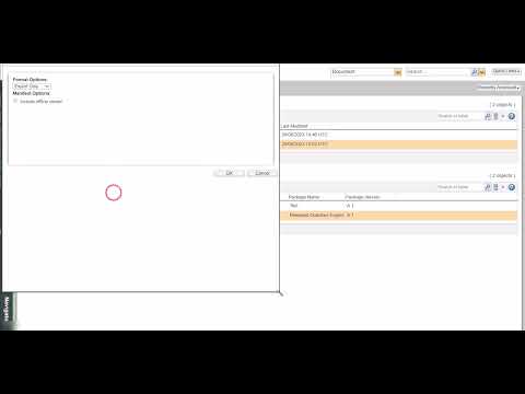

I'm sure this video helps you
Creating Packages for exporting data
PetrH
Creating the package: (0:00) Creating the delivery and zip file: (1:57) #windchill #cad #plm #creoparametric #tutorial #engineer #engineering #structuralengineering #mechanicalengineering #civilengineering #design
