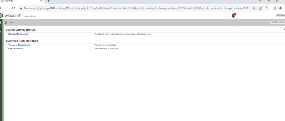

I am using Windchill PDMLink Release 11.2 and Datecode with CPS 11.2.1.17
After update of release to 11.2.1.17 wcadmin (Administrator) is no longer active. All other users are working right but wcadmin no. I can't publish cad document in this way

Hi @FC_9723361
This is problem with disabled profiles, remove the admin from all groups
then you'll see all be fine.
Exclusion group usually is added to others license groups that uses disabled profiles, and the disabled profiles case this behavior.
PetrH

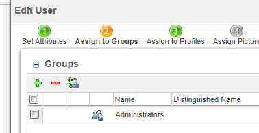

Hi @FC_9723361
This is workaround
Log in as a wcadmin
go to administrators on the site you should see this
go to the wcadmin user detail page
use Actions and edit the user,
remove them from all groups and profiles

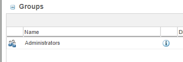

Use workaround 1 on this support page.  Once you have access to the profile for wcadmin, remove it from all license related groups (including license exclusion).

@TomU and @HelesicPetr , you are on the right track, I had this issue when I was upgrading to 12. I had the wcadmin in the exclusion group in addition to Administrators group. You can try fixing it with another site administrator, remove the exclusion group from wcadmin since its already in there cause they are part of Administrators. The only group I have them part of is Administrators.
