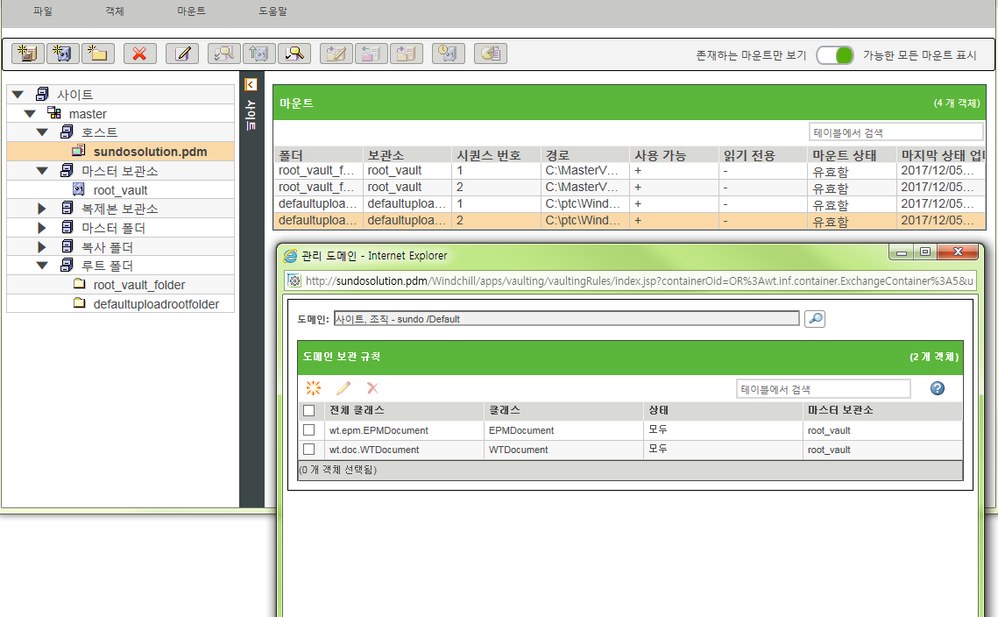

Hi
windchill has default vault, in my case path is "D:\ptc\Windchill_10.2_M030\Windchill\vaults\defaultuploadrootfolder"
and i create new master and folder.that path is C:\root_master_folder
after that i create new storage rule
storage rule was file that Domain is 'demo org' and type is 'EPMDocument' and status 'all'
file go to new vault
but it look like there is no difference
cause default vault and created vault size same
Configure vault to speed up windchill by reducing the size of the BLOB in the database
Is not it?
What is the purpose of using vault?

I configure follow :
We have check-in documents and CAD data into products under the organization.
Both the primary vault and the configured vault have the same file.
Files in the default vault are not removed
To keep files in a vault set by a retention rule and remove files in the default vault
What should I do?
