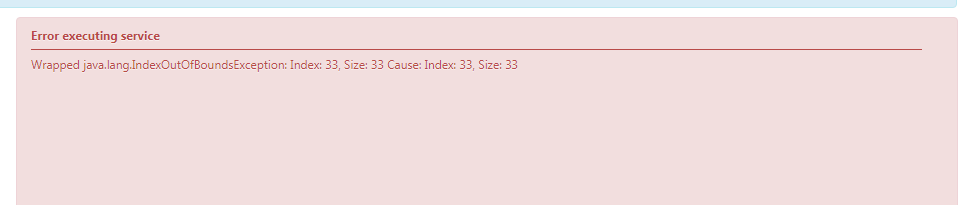

For this code snippet I'm getting this error
where 33 is the row count of  infotable 2 (rem in the above code)
How do I copy values? What is the alternative here?
