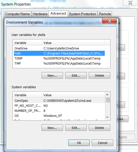

Hi Abhijeet, Tomcat is unable to find the library path. Follow the below steps to resolve the issue:
1.On windows, click Start->Configure Tomcat and in the Java options field, remove the " -Djava.library.path=C:\ptc\Tomcat 8.0.44\webapps\Thingworx\WEB-INF\extensions" and just keep the below lines:
      -Dserver -Dd64
      -XX:+UseNUMA
      -XX:+UseConcMarkSweepGC
      -Dfile.encoding=UTF-8
2.Go to the explorer, right click on "my computer" --> Properties --> Advanced settings --> Environment variables --> edit "PATH", add ; and then path to your tomcat extensions folder, " ;<path to extensions folder of tomcat> "
or, for example ";C:\Tomcat 8.0\webapps\Thingworx\WEB-INF\extensions"
3.Restart Tomcat.
Hopefully, this helps to resolve the issue.

Thanks yamini for the quick help. I re-configured as per the suggestion. It does not work.
i even re-installed and configured a tomcat to different location with above setting but no luck. it gives same error message.

August 2, 2017
Could you please try setting the path: C:\ptc\Tomcat 8.0.44\webapps\Thingworx\WEB-INF\extensions in the user variables section as shown below:
Let me know if this works.
