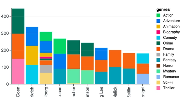

Using Thingworx i want create barchart with multiple colors,we are having multiple catagories
  • March 22, 2021
  • 2055 views
I am having multiple catagories with different data for each data i want to show multiple colors in one bar. Can someone help me out. Is there any extension available? Please find attached screenshot
Best answer by wcui
Hi Bhavya, I think below article can better answer your question.
Please add Bar Chart Widget in your mashup, then check article Resolution -> Image3, set widget property SeriesDisplay to "100% Stacked".
Please also read article for other property settings such as NumberOfSeries, X-Axis-Field, DataFieldx.
https://www.ptc.com/en/support/article/CS340527
