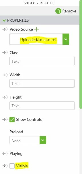

  • Drag 3 video widgets on to the 2D canvas, uncheck the visible property of all the video widgets and upload the resource in the Video Source as shown below:video.JPG

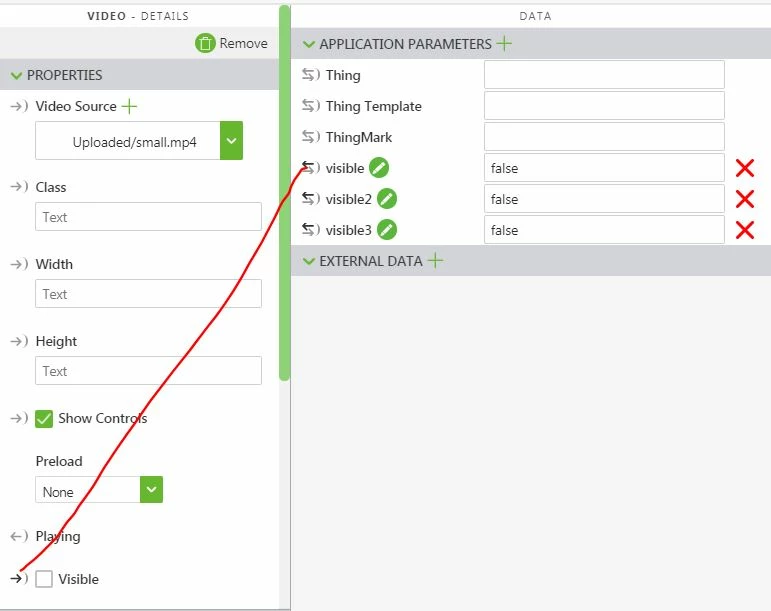

  • Create 3 application parameters with any desired namd in the Data panel and set it's value to false.
  • Drag the binding icon next to the application parameter and drop it on the visible property of the video widget as shown below:
  • Repeat the same for other two application parameters. Bind them to their respective video visible property.

August 28, 2018
Make sure you have the video Widget visibility set to true. If it is false the video will still play even though you can't see it but you will still hear the audio.
In my experience on Android videos will play in a window by default but on Apple they will force to full screen using the native video player.
