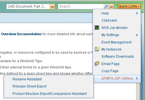

A screenshot of my "GPMFG JSP Utilities" custom menu:
Customized Quick Links menu
