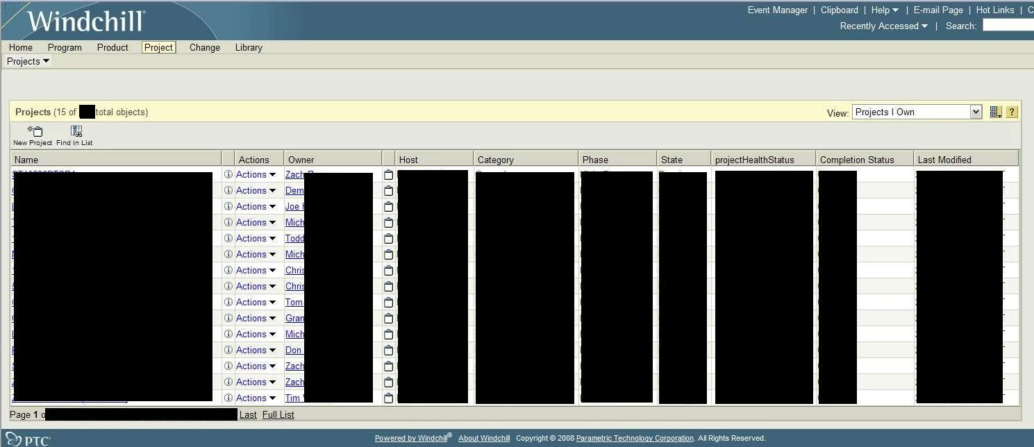

We have a test system that we recently updated from 9.1 M020 to 9.1 M050.
All seems to be well...except the following quirk: When a user (any user) is looking at the list of Projects in ProjectLink, if they select the View "Projects I Own", it does not limit the table to Projects for which they are the owner. Instead, it shows all Projects of which they are a member...which in our system is the same as "Projects of My Organization".
The View error is present in IE, FF, Pro/E, and the SW WGM. In the attached screenshot, you can see that there are different Owners listed in the table, though the view is set to "Projects I Own". This worked fine on this exact installation when it was running 9.1 M020.
I have a call open with PTC, but thought I'd ask if anyone else has experienced this. Anyone?
