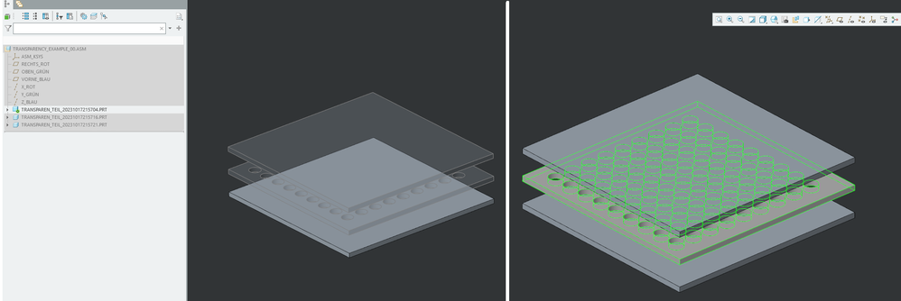

When I activate parts in Creo 10.0.1.0 the transparency hides holes/oulines of other parts. Here is an example. None of the holes are shown, once I active the lower plate. Is there any way to change that?

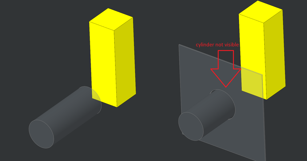

The problem appears when there are other inactive parts in front of that. Example:

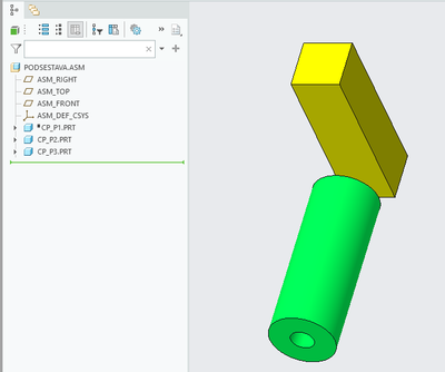

Creo 10

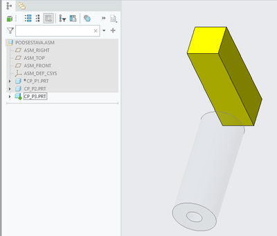

Here the difference to Creo 2:

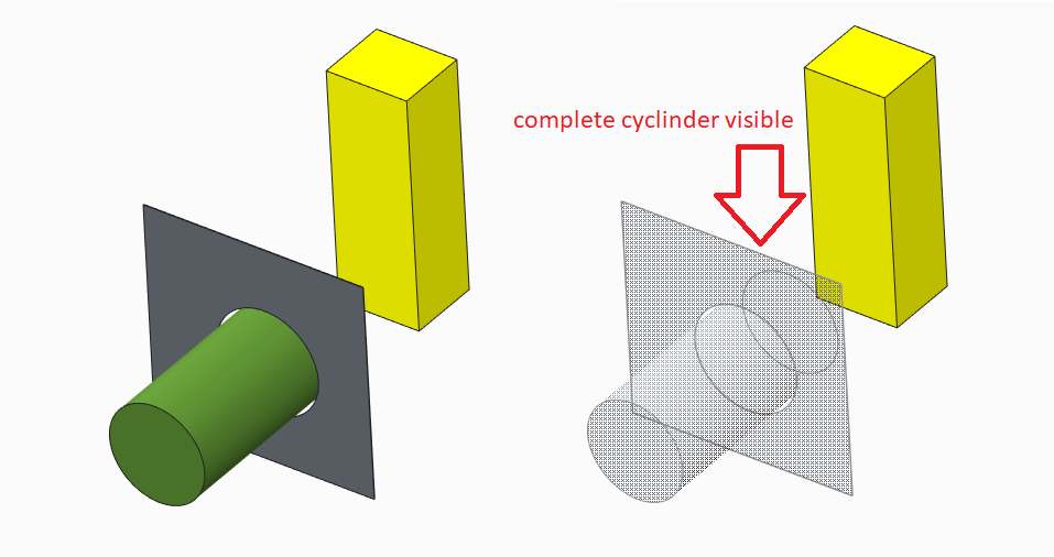

I am able to reproduce your "problem" even in Creo 7.0. I think Creo works the way "as designed". Please contact PTC Support and discuss the problem with them.
Note: Your cylinder is hidden behind grey plate and therefore it is invisible. If you if you reduce the size of grey plate then you will see the end of cylider
You can turn off the "dimming" of the inactive components using
dim_inactive_components never
I don't think this is what you want to do but just thought I would suggest it.
