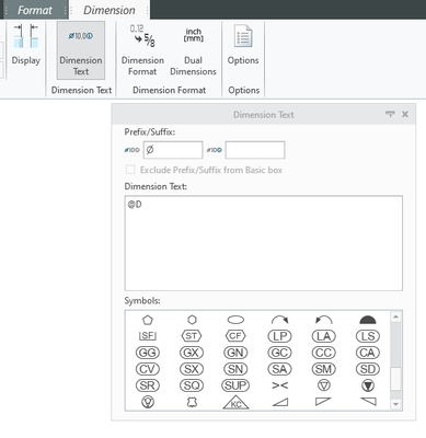

I would like to add the symbols GX, LP etc. in the symbols of the dimension text, as they are not present. Where do I get these symbols according to ISO GPS and how can I make them available in Creo 4?

This is already supported in Creo. all you would need to do is to update the following model/detail option via the File-->Prepare-->Model/Drawing properties--->Detail options UI.
After updating the "symbol_font" detail option to any value other than "legacy", you will get the extended text symbols pallet:
Thanks @Mfridman for the tip. I can adjust the detail option as described, but unfortunately I don't get any additional symbols. Are there any other settings that I need to consider?

Are there any circumstances where two created dimensions of the drawing would behave differently? I have a dimension that is created for a feature where I can see the extended symbol gallery, creating a new dimension on the same feature and cannot see the extended symbols.
Read through this thread carefully.
If the dimension showing the extended symbol is coming from the model, but your added dimension is in the drawing, or the reverse, that would explain it.
