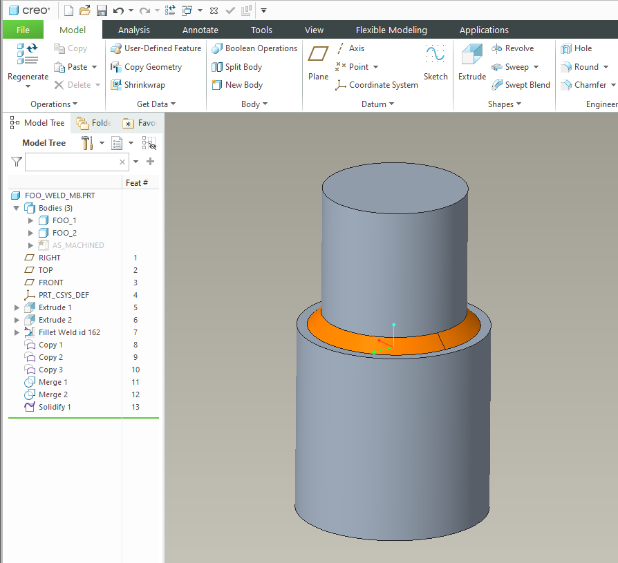

Here is an example of how to structure this using multibody modeling for the welded parts. Let me know if this in theory would resolve the issue of accessing the parent model of the as machined part. I have some other ideas that might work but I want to get your feedback on this approach first as it is easy to follow.
The part FOO_WELD_MB contains 3 bodies and 1 weld feature. This is seen in the below image model tree. I used a construction body to combine the geometry of the weldment that will serve as the as machined solid. This is the hidden body "AS_MACHINED" seen below.
Multibody weldment part modelMultibody weldment part model

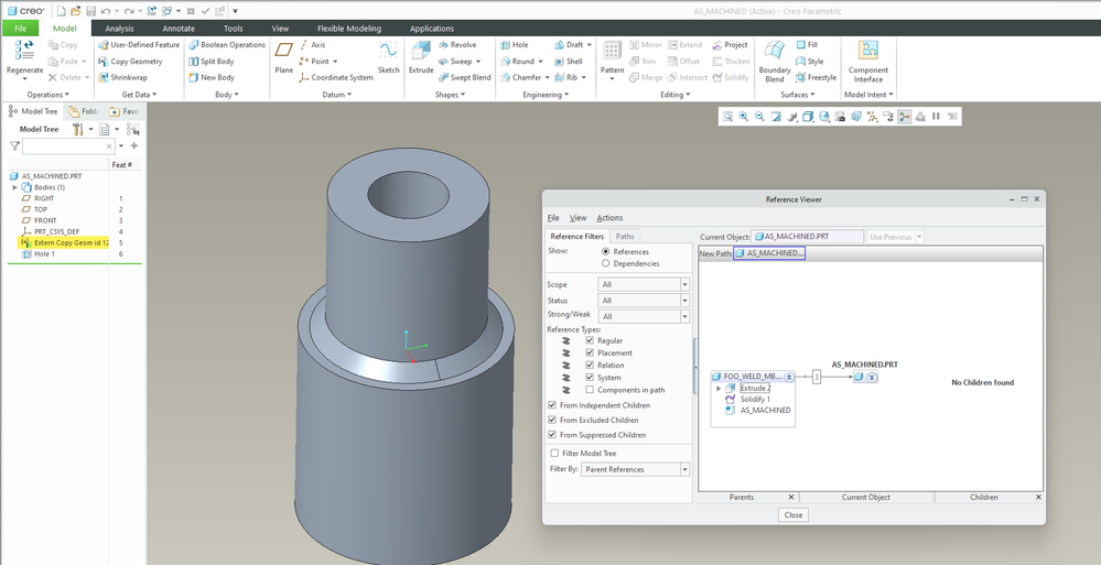

This shows the as machined model which was created using the create part from body option in the part shown above. This includes all of the solid geometry of the parts and weld and uses an external copy geometry. You can access the parent model of this copy geometry directly from the as machined model.
As machined weldment modelAs machined weldment model

Thanks for the feedback. The right click open reference model works nicely.  However I  have a few question for you.
