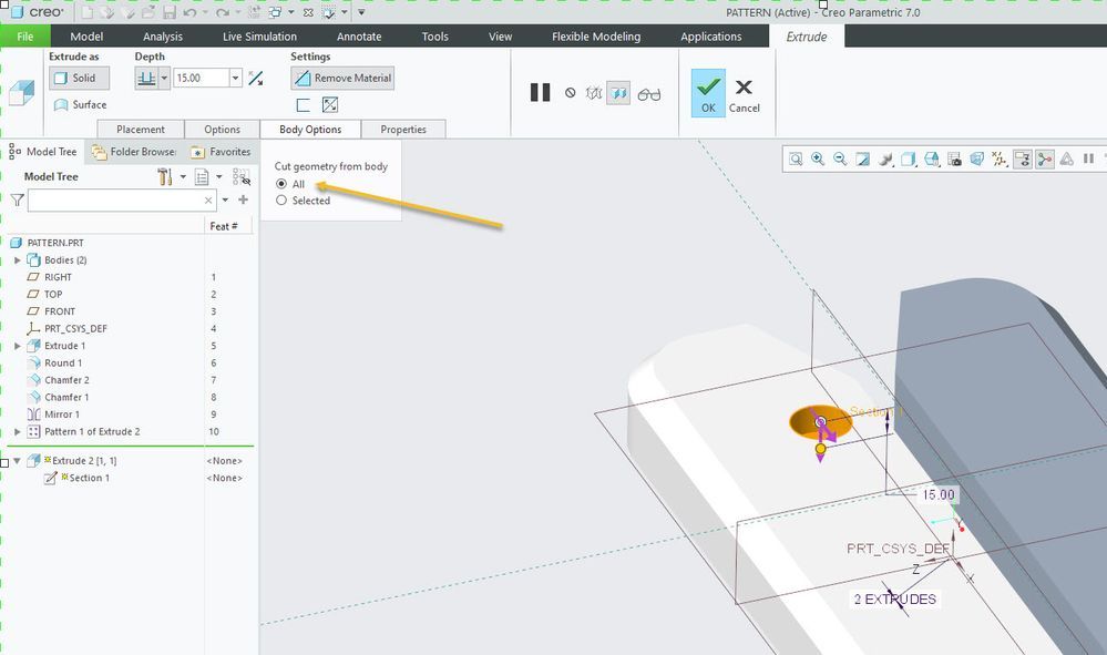

Dear sir, could you please share the reference pattern enhancement part for understanding the model tree.
the reference pattern enhancements related to some bug fixes to increase stability and were not related to the model tree.
Dear sir,
How you create the pattern of cut into 2 bodies, this is I want to know so that why i ask for model.
Because I try this but i wasnt able to create same scenario.
did you use the cut-through-all-bodies option?
Thank you sir,
Small small thing is very important.
